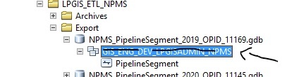

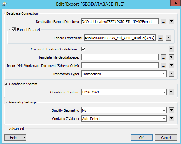

I am using a fanout /fanout expression to extract records based on OPID and SUBMISSION_YR
Is it possible to get rid of the of the feature dataset from showing up , so only a feature class is within a FGDB (File geodatabase) ?? The output is in ARCGIS
see screenshots below
debbiatsafe
Forum|alt.badge.img+24
Hi @curtisd54​
Try deleting the geodb_feature_dataset format attribute from features before writing to the file Geodatabase.
Happy holidays!
