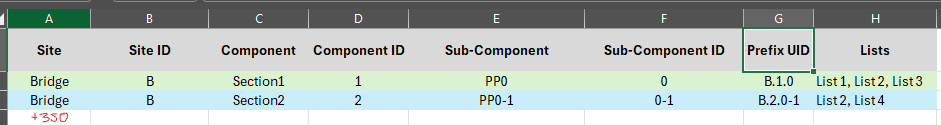

The problem I am running into is that the data have been provided in Excel. There is a “SiteVisits” Tab, and a “Lists” tab. The SiteVisits tab has 350+ records, with columns containing Site IDs, Component IDs and Sub-Component IDs, and a column on the “Lists” required for each Site.
SiteVisits Tab, with 350+ records

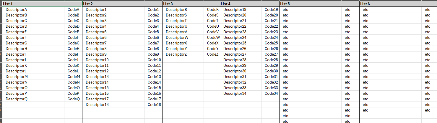

The “Lists” Tab contains a descriptor of each checkbox and the associated “Code”. What I am trying to do is concatenate the easy parts of the UID (“Site ID”. “Component ID” . “Sub-Component ID”), with each of the “Code” values on the “Lists” tab.
Lists Tab, with relevant codes for each list. Note that the List # row is two columns merged together

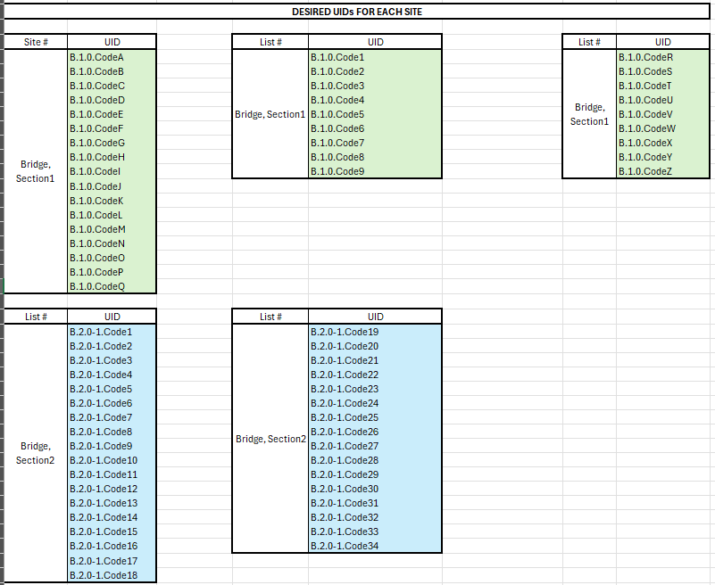

I am trying to tell FME to explode the column that outlines all the “Lists” on the SiteVisits tab, and then Join all of the relevant “Codes” for whichever “List” is required for that site, and then generate the codes with an AttributeManager. I’d then end up with a whole bunch of UIDs, examples are shown below:
Examples of desired UIDs
There are around 350 Sites. Each site has multiple lists, and each list has multiple codes, and there are a total of 73 lists, so I’m looking at an output of around 20000+ UIDs. I have attached a trimmed copy of the data provided. This contains the “SiteVisits” and “Lists” tabs mentioned above, with examples of the desired UID outputs in the “SiteVisits” tab.

Hi there, thanks for this! How do I combine all of the list tables into one column? The columns with the codes are the List # + “00” since the List # is a merged cell in Excel:
