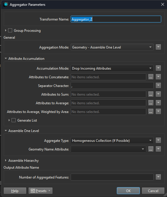

Hi ​@takashi ,
Can you please tell me what parameters should i use in aggregator
I connect geometry filter first, and i get Area, so what should i do next?
Thank you in advanced
takashi
  • April 28, 2025
Check Group Processing, then
  • Group By : <select unique ID attribute>
  • Complete Groups : When Group Changes (Advanced)
If the input features don't have unique ID attribute, consider add sequential number attribute as temporary ID by inserting Counter before Aggregator.
Note: If you use GeometryFilter to separate Area and MultiArea, set "Detail" to the Mode parameter and "IFMEArea" the Output Port parameter.
