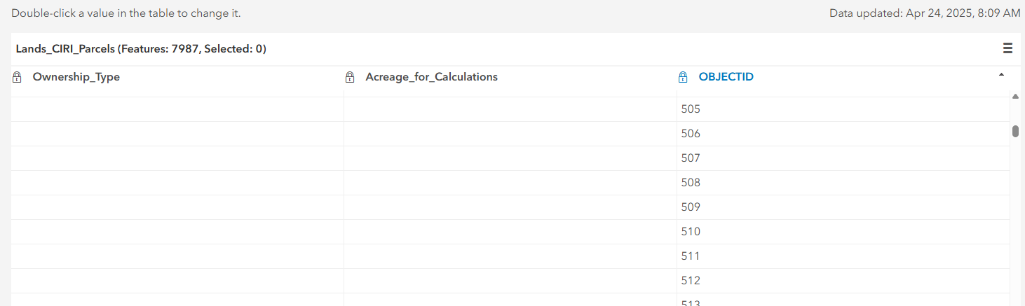

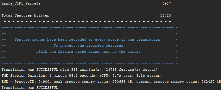

I have a very basic workbench that includes one section reads from an SDE and writes to a hosted AGOL layer. It is set to truncate existing. The script writes all the polygons as expected but none of the attribution for the polygons comes through.
I have confirmed the attributes are correctly named. I have tried removing and re-adding the hosted writer.
Weirdly, the script also writes different data to a separate hosted layer and that functions fine.
Has anyone else had this happen? Any ideas on solutions?
