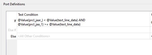

I have a parcel data with various years in the postgis database and I need to executed topology year wise to find out the topology errors across the years. I have query to filter out the data in year wise and the query is (column1 < Year and column2 >= Year).
My first question is how to retrieve the various years in DB for that particular area and my second question is how to pass the years to fetch the data pertain to that particular year and pass it on to the dissolver transformer, kindly let me know.

Thanks for the reply . I tried the solution but I am facing difficulty to add the condition like (column1 > year AND column2<year) in attribute filter , could you please help me in this regard . In addition I need to loop the year starting from 2000 to 1830 and for each year I need to apply above condition to fetch the parcel from DB and find the topology errors if any.

I need to check the fabric topology year by year starting from 2000 to 1830 (I have the list of years in a text file). For that I need to use one condition (column1 < year and column2 <=year) . For that I am using the test filter, dissolver and dotnutholeextracter. My question is how can I pass the year one by one to the test filter , so that dissolver and dotnutholeextracter will identify the gaps in that particular year.
