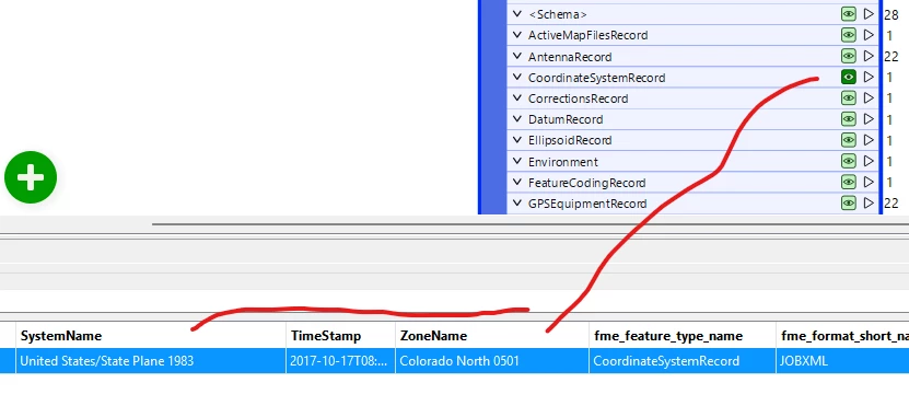

I am reading many jxl files. Each jxl has a "CoordinateSystemRecord". 1 for each file. howver this is not a standardized CS as recognized by fme.
It has an attribute for ZoneName which is a text value like "New Mexico East 3001" and a SystemName attribute like "US State Plane 1983".
How can I use these to set the coordinate system value as the file is read?
i currently have the coordinatesystemextractor transformer in my wb. but the value is empty.

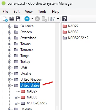

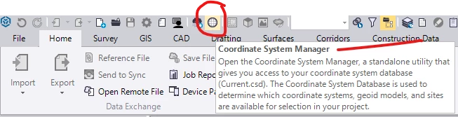

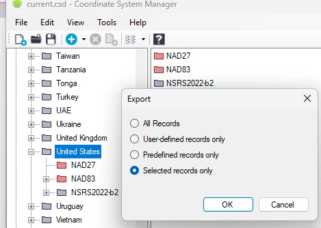

  1. open TBC
  2. open coordinate system manager
  3. Since i potentially need NAD83, NAD27, and NSRS projections I put my cursor on the United States
  4. File>export
  5. export the selected records only
  6. change the saveas type to *.JXL
  7. this will create a folder with jxl as an extension.
  8. This folder contains 2081 jxl files.

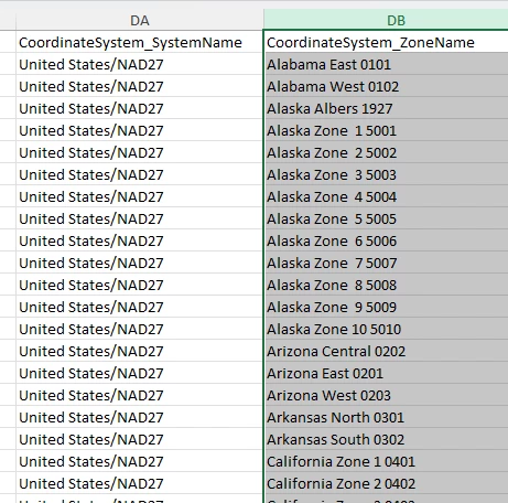

  9. Each jxl contains 2 xml branches, 1. Job-Metadata 2. Environment

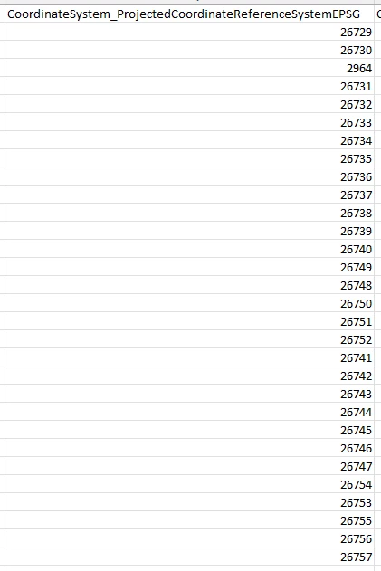

  10. The environment contains an attribute called CoordinateSystem_ProjectedCoordinateReferenceSystemEPSG

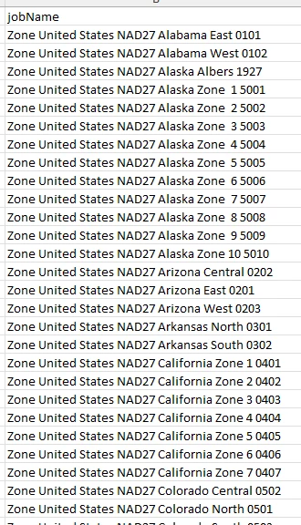

  11. I have not started the match yet but these values along with a concat of CoordinateSystem_SystemName & CoordinateSystem_ZoneName
  12. with minor cleanup will render the normal trimble projection name and allow a universal (epsg) match to any other system.

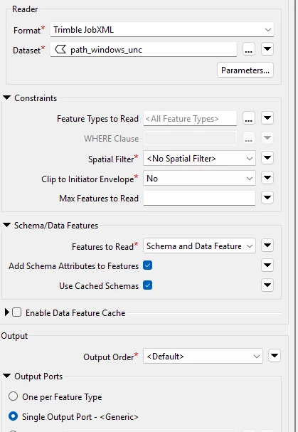

  13. build the workspace with the list of jxl files (or one). use the featureReader or the JobXMLReader, Add Schema Attributes to teatures, and expose the schema attributes (especially CoordinateSystem_SystemName, & CoordinateSystem_ZoneName).
  14. generate a list of feature types by using one of the jobxml files.
  15. concat the SystemName and the ZoneName and WALA you have a way to use the lookup table you created earlier to match to the epsg.
  16. then all you have to do is manage getting the point reductions stream merged with the CoordinateSystemRecord.
