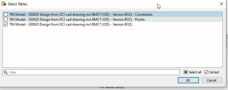

The geopackage causing the problem is included in this file. I hope somebody at Safe is able to assess the problem.
When using the OGC Geopackage reader, and selecting the following layer (see reader parameters dialog screenshot), I get the abovementioned error.
I'm using FME(R) 2020.1.0.1 (20200710 - Build 20596 - WIN64) and the OGC Geopackage

​Hi @r_huesken​,
It doesn't look like we support TINs in the Geopackage reader just yet but my colleagues were able to find a workaround using the SQLite reader and then replacing the geometry with well known binary to suceessfully read the TIN (thanks to Mark S and Jake!).
I've attached the workspace template here, please give me a shout if the data needs to be removed from the template. I've wrapped up Jake's workflow in a custom transformer so you should be able to just run it and the AttributeFilter will filter out your feature types to TIN, Point, and Constraint. Right click > Edit on the custom transformer if you're interested to see what's inside, but you should be able to work with the TIN without having to make any changes to the custom transformer.

Hi @jovitaatsafe​
Sorry for the late reply, I had to look after some other issues .
Thanks very much for both the explanation and the work around. This is not a straightforward solution, and it will save me a lot of time transforming the data for our client.
I'd appreciate if you could remove the data from the template, since I guess this solution may be useful for other FME customers as well.
