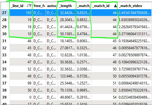

Hi guys. I need to add the lengths of all the parallel lines in an DWG file using FME. I used the FuzzyParallelLineFinder to try and accomplish this. After using a Tester to filter out all the "Attribute is Missing" results I am stuck.
  • Aug 7, 2020 3:43 AM UTC
  • 101 views
It appears I now need to add all the _match_id(s) with their correlating unique _line_id by length.. Any tips on how to do this?
Thanks in advance,
Fred
Best answer by daveatsafe
Hi @fredtaylor​ ,
One way might be to use an AttributeCreator to multiply the length of the line by the match_overlap to get a match length, then use an Aggregator to group by the match_id and sum the match lengths.

Thanks Dave! That helped a lot. Cheers
