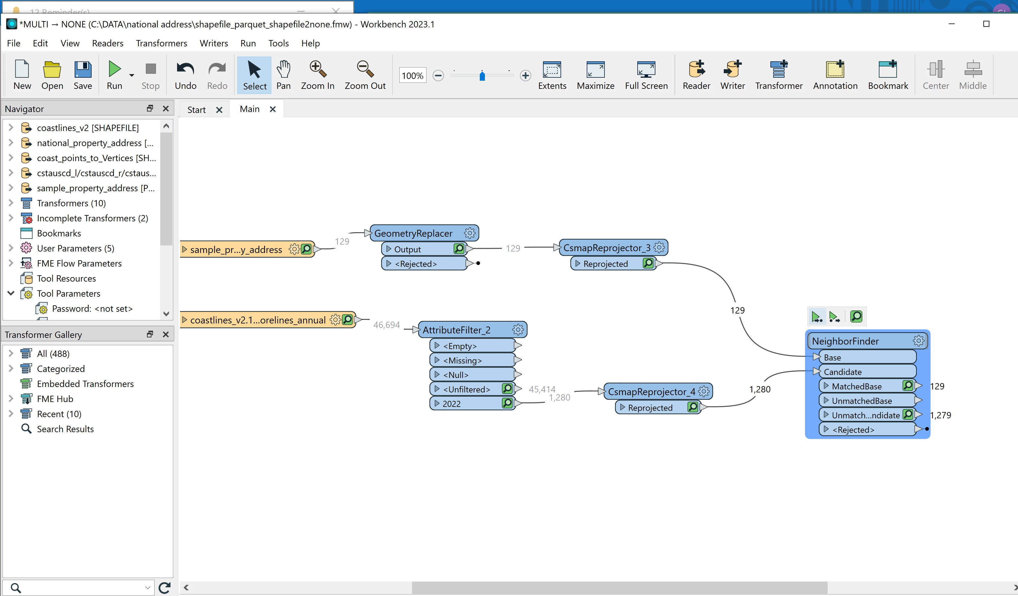

Hi All I have a point distance data set in a parquet file with x y coordinates and a geom column with geometry encoded in hex binary and i have line data for coastline I want to calculate distance between these points and the coast polyline .In my workflow am using geometryreplacer to get the geometry then projecting both layers using csmapProjector then using neighborfinder but am getting unexpected results ...is there a better approach

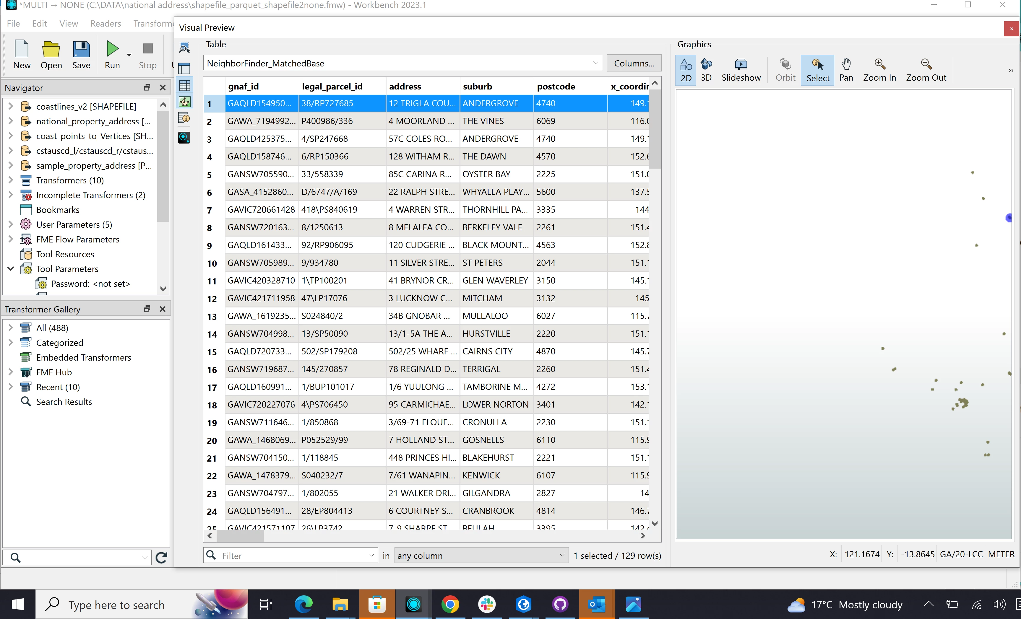

below is my workflow and the results the distance column is very similar no difference between points even though there should be ….the points are address points from different location I am expecting distance to vary

So you’re either working in GDA94 or GDA2020 depending on which one you downloaded and then reprojection to a LCC. Can you try simply using a VertexCreator (it probably creates a geometry automatically from the reader) with the x, y and then show the output attributes of the neighborfinder (E.g. “_distance”).
You can also troubleshoot the results by creating a line to see the distance it’s measuring by using a VertexCreator with “Add Point” and the candidate x,y values.

yeah I am reprojecting it to espg 7845  the thing is I used the same dataset with gnaf with the same workflow to calculate distance to another dataset of points and this worked but it doesn’t seem to work with coast data maybe because it is multi line as well
