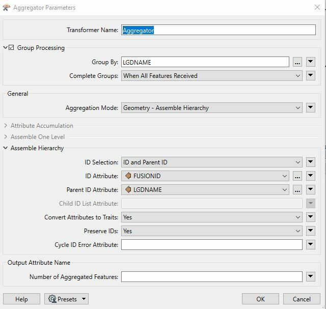

Is there a way to group by an attribute in the aggregate transformer so that they are multipart but keep all the other attribute information?
  • Jun 28, 2023 10:13 AM UTC
  • 179 views
nicole.mcstay
Forum|alt.badge.img+5
I am using the aggregator transformer to take multi part polygons across NI, grouped by Local Government District, so when the data is displayed and selected on a map the records in one district will be selected as a multi part. I want to keep all unique identifiers and addresses for the records, as well as other attributes. I have currently got all the attributes to remain by using the assemble hierarchy section in the transformer using LGD as parent id and unique id as the id, but the group by doesn't seem to be working as the records are being selected as individuals polygons, not multiparts.

We can’t send the data as it’s under copyright. I am using FME(R) 2022.1.1.0 (20220728 - Build 22623 - WIN64).
This is my workspace.
workspace
Before the data goes through the aggregator it has the LGD and Fusion ID assigned (see below)
Data BeforeAfter it has ran through the aggregator the records still contain the data 9see below) but they are not multipart. Each record is still highlighting as an individual rather than all records within the LGD highlighting together.
After aggregator
