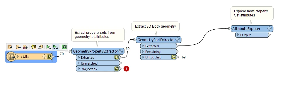

I am trying to convert an IFC TO CESIUM TILES 3D with FME 2022. The projection EPSG:3857
I tried an d follow the explation here:
https://community.safe.com/s/question/0D54Q00009TdMzbSAF/cannot-convert-ifc-file-to-3d-tiles
But i got this has an error:
  • The below feature caused the translation to be terminated GeometryPropertyExtractor_<Rejected> (TeeFactory): GeometryPropertyExtractor_<Rejected>: Termination Message: 'GeometryPropertyExtractor output a <Rejected> feature. To continue translation when features are rejected, change 'Workspace Parameters' > Translation > 'Rejected Feature Handling' to 'Continue Translation''

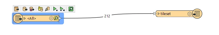

I also tried to convert directly an i got this:
  • CESIUM3DTILES writer: Unable to reproject the 'EPSG:3857' coordinate system

To prevent the workspace from stopping when a Rejected feature is encountered, try changing the Rejected Feature Handling parameter in the Navigator window to 'Continue Translation'. This will allow the workspace to continue even if the GeometryPropertyExtractor rejects a feature. You can find the parameter in the screenshot below. This should resolve the issue you're having.
