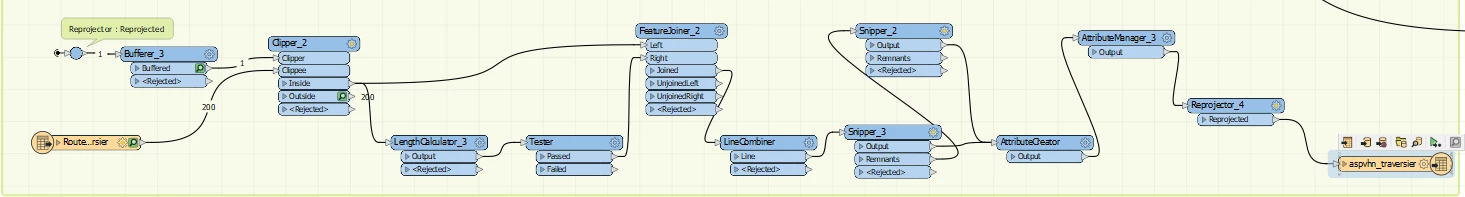

Hi,
I would like to change the results of a GeoJSON writer when there's no attributes that pass my transformers. For example, when I got what its like in the left picture, I got a reply from my GeoJSON writer like so : {

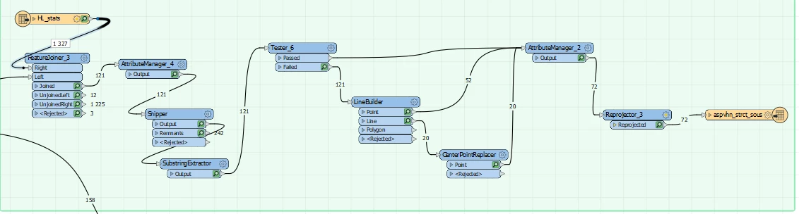

But, when its like the right picture, I got nothing from the GeoJSON writer. What I want is that when I got no attribute that pass my transformers, i'll still have an answer that looks like what you see as above but with space instead of nothing at all. Thanks.

Just before your writer, insert a NoFeaturesTester. Send the OUTPUT port to the GeoJSON writer. Then send the NOINPUT feature to a Text File writer with the same name as the GeoJSON output. You may want to introduce the attribute "text_line_data" with a space first.
