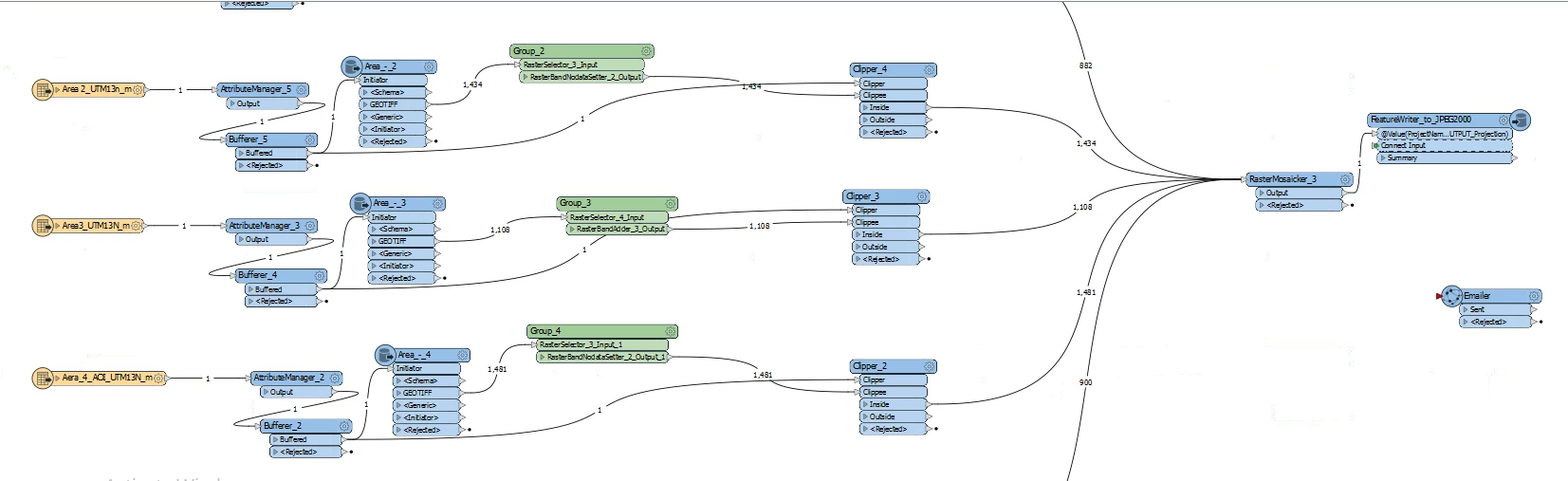

I am trying to mosaic 5800 geotiff images that average 260 MB in size. I need to mosaic all these images together. I am not sure if i'm doing this the best way
  • Oct 21, 2020 2:32 PM UTC
  • 81 views
The files are in (5) different folders that i'm reading the data from. I'm writing the final mosaic out locally and as a single file at full resolution. These images cover a large area and the final product will be hosted on a web server. Any suggestions on best way to process this out than putting it all thru rastermosicker? My original flow is snipped below.

First impression is that it's not going to work, or that it's not going to be a good solution, because the resulting file is going to be just gigantic (~1.5TB).
Why cannot the web server use the collection of smaller files? In my experience, that is usually how these things are done.

I think you have to read on how a web server works.
Your method is the way to do it, if you want, but it will take forever and change and a lot of resources (RAM, disk space).
A web server usually uses tiles to show large maps. If I were you I would split the 260 megs files in smaller ones to optimize for speed (server speed).
