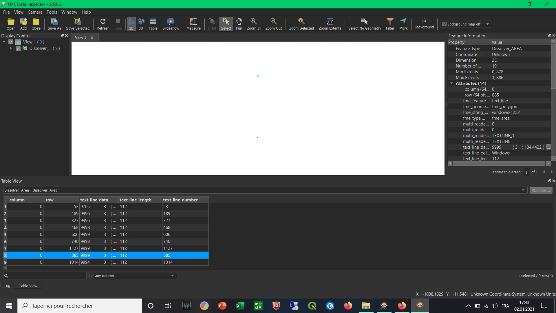

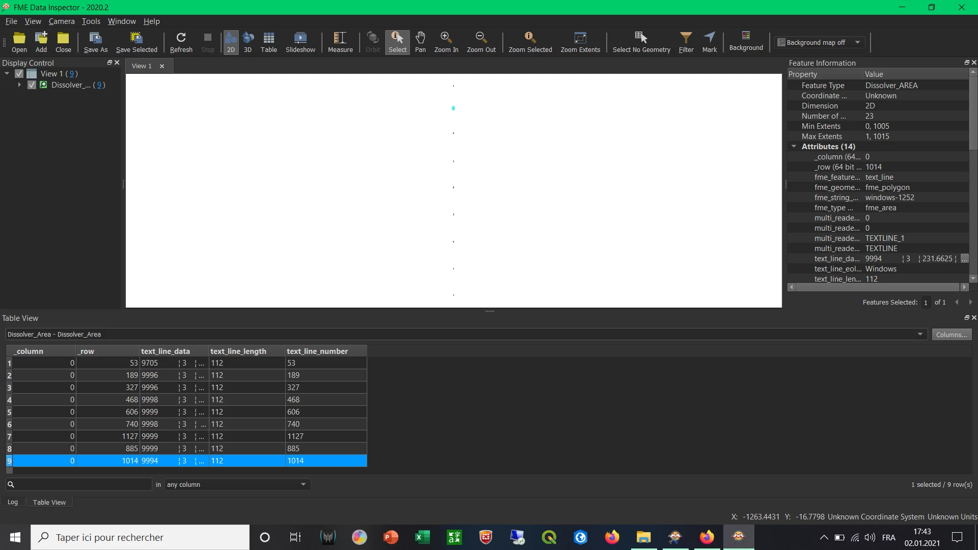

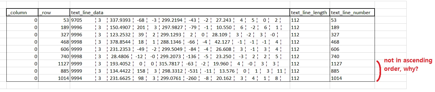

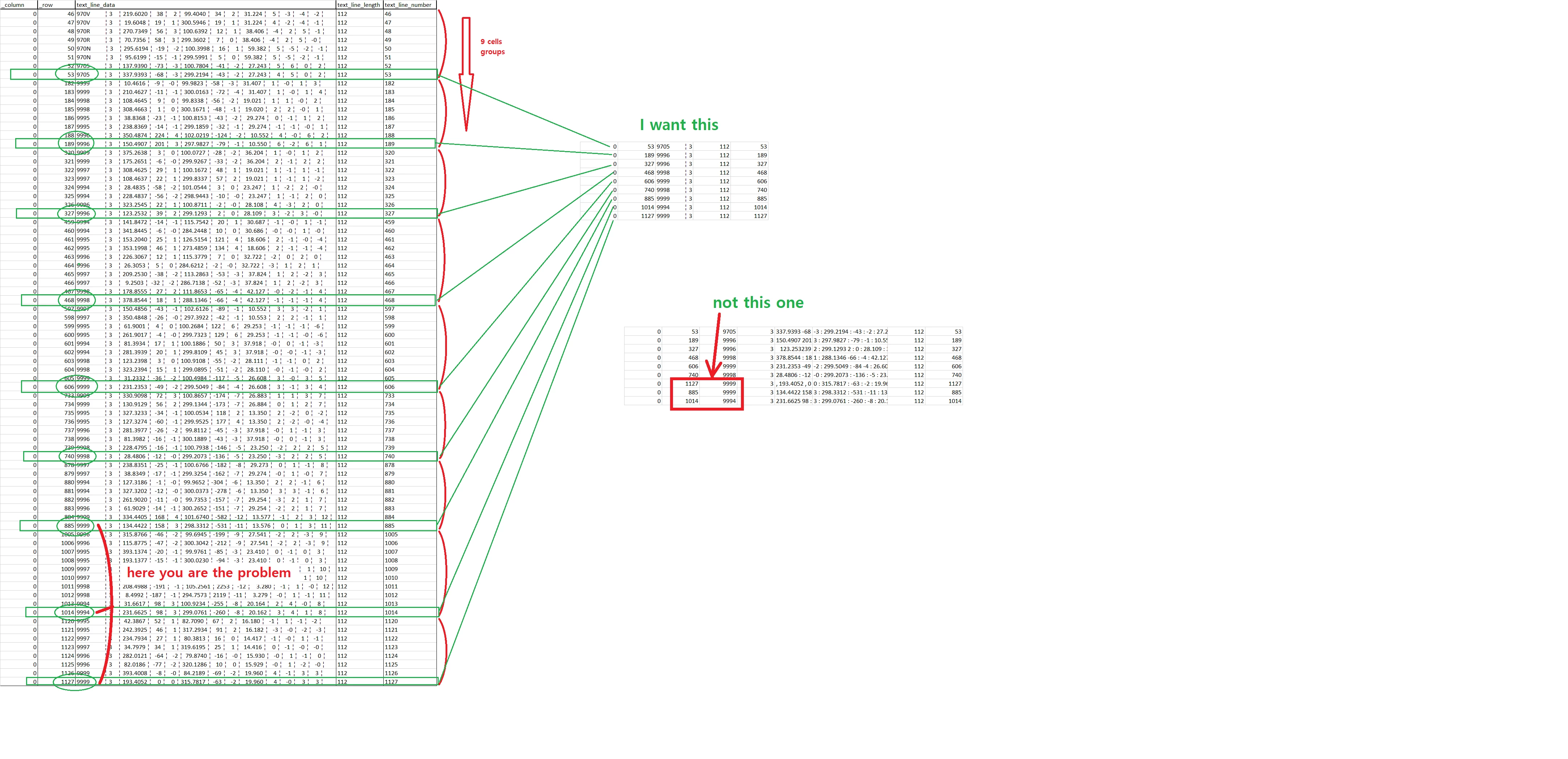

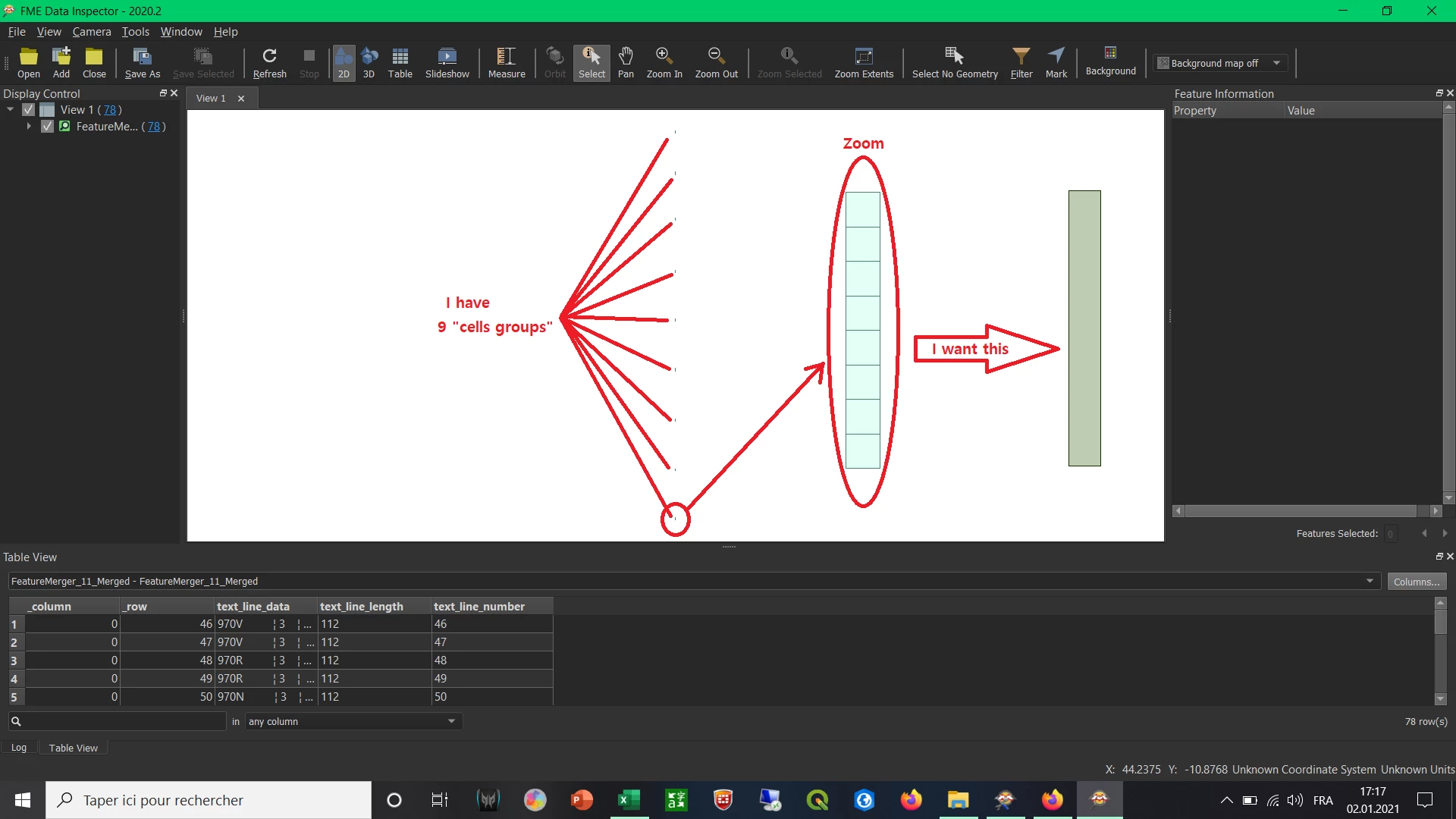

I have 78 cells divided into 9 groups (attached image), and I need to dissolve in 9 rectangular in the right order (ascending), but, if I dissolve, it doesn't make it in a order ascending (attached images of attributes). Any advice?

Any way, I just don't understand why I must to "sorter" after the dissolver to have data in the right order (ascending). If I make workflow like--> dissolver+sorter(line_text_number or _row ascending)...It's ok! But why "dissolver" doesn't dissolve data in the right way immediately?

Yes but it is anyway strange cause datas in the outport "merged" of the "feature merger" are in order ascending! I cannot see this change order in the feature merger.
