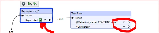

Hi everyone I am using TestFilter transformer to filter my attribute data. Once I run it, the transformer log saying it was Successful but I can not see the catched feature "green magnifier" Do you know why it is happening?

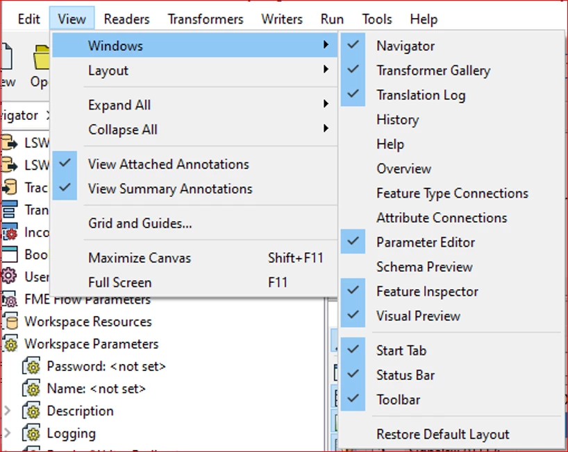

I have closed and open FME and run the workspace, I have enabled Visual Preview, and Feature Caching as well but still can not see the results in transformers.
I appreciated if someone can help me.

@myadegaryiutac​ Hi there, thanks for bringing this issue to the Technical Forums. It looks like you're working with FME Form 2024.0 beta, and I can confirm that this is a known issue internally. The service ticket tracking this issue is FMEFORM-30089, and I can see that it is currently being worked on by our developers. The fix for this issue should be included in the official release of FME Form 2024.0, so keep an eye out for that.
Our beta builds are typically for testing and preview purposes, and should not be considered production-ready. If the affected workflow is used in a production capacity, I would recommend making use of one of our stable releases in lieu of the beta. You should see better results with feature caches in FME Form 2023.2, for example.
Please let me know if you have any further questions on this issue!
