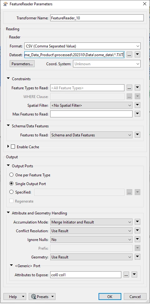

Hello @johnt​, sorry for not reaching out again sooner! Can you pass along a screenshot of your FeatureReader parameters please? I want to make sure I have everything configured similarly. All the best, Kailin
johnt
Forum|alt.badge.img+14
  • Nov 3, 2023 4:09 PM UTC
Hi @kailinatsafe​ , also sorry for late reply - busy week! Please see attached, but that attachment widget thing is horrible. Only one image per reply it seems. I did try changing the Feature Type Name(s) parameter to File Name - and other variations. I have a work around to read as Text File with text_line_data and splitting by comma - but I can only do this as the data is a known quantity and good quality, i.e. no commas expected in the data.
