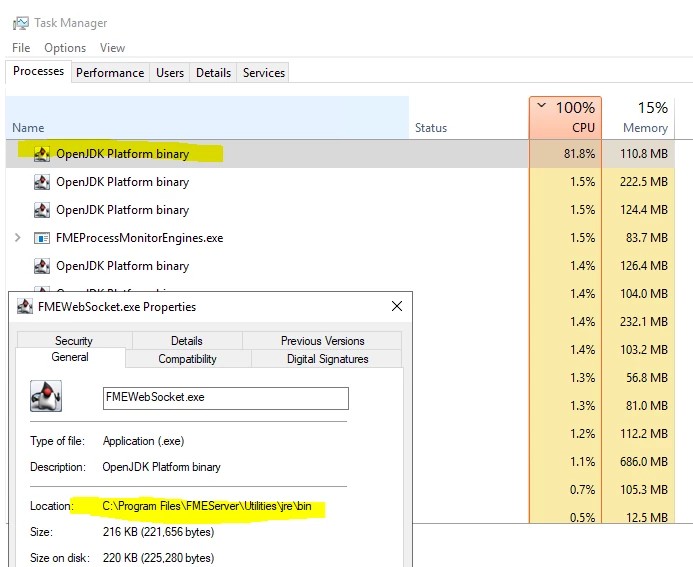

Why is FMEWebSocket.exe consuming very high CPU continuously in the background?
  • January 23, 2022
  • 77 views
Currently running FME Server on Windows Server 2019. The Windows server is being handicapped by high CPU usage by the FMEWebSocket java process. Please see the screenshot attached.
steveatsafe
Forum|alt.badge.img+16
  • January 24, 2022
Hi @gsanders​  What version of FME Server are you using?
Have you reviewed any of the log files? Check the fmeserver.log for any activity and see what you can find in the Resources>Logs>service>current><hostname>_fmewebsocket.log. Feel free to open a support case.
Have you attempted to stop the FME Server Core service? If you do, make sure there are rogue processes running, then start the FME Server Core/Engines services back up.
