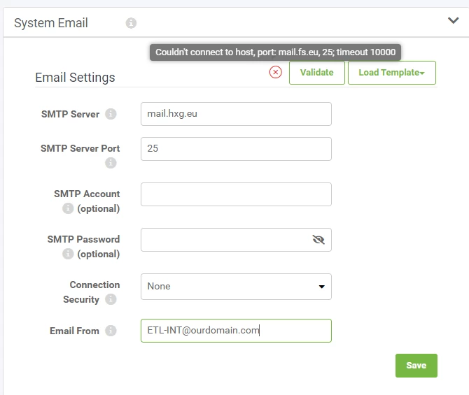

Hello,
I'm facing a strange issue configuring FME server eMail.
The same parameters that work for the eMailer transformer inside a published workbench, raise an error when used in the FME server eMail configuration.
The error is "couldn't connect to host,port" (attachment).
Suggestions?
TIA
Roberto

I don't have a solution for you but I can confirm that there are differences between the Emailer and the other FME Server email configs, especially in cases where authentication is done by ip address rather than username/password. According to tech support they use different libraries.
