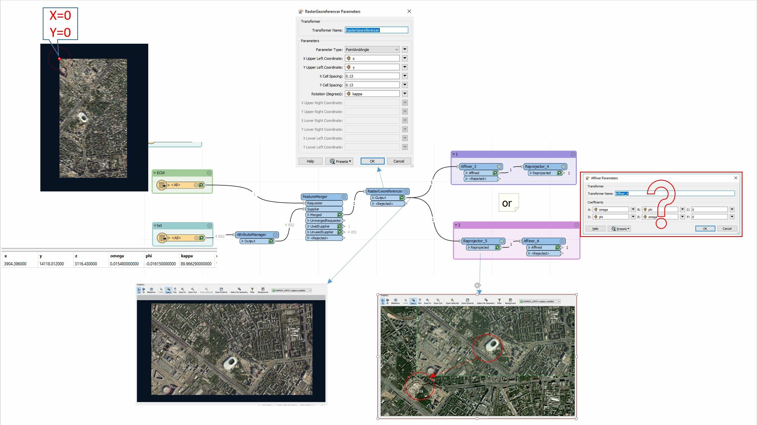

Hello, I have pictures in ecw format and txt description of the position from where the shooting was made with deviations according to omega phi kappa. How can you project an image onto a surface taking into account all the parameters?

david_r
  • Sep 22, 2020 10:42 AM UTC
Have a look at the RasterGeoreferencer transformer.
Depening on the circumstances you may perhaps also want to look at either the AffineWarper or the Affiner.

Thank you so much! I can see the direction for the solution. But could you help me. I don’t understand at all. I read the documentation for the AffineWarper and the Affiner. I think, it would be better to use the Affiner. But I can’t get the correct result.
I suppose by omega, phi and kappa you mean roll, pitch and yaw, as in you're doing orthorectification?
If so, that is unfortunately outside of my area of expertise, but maybe try googling for things like "orthorectification affine" etc to see if anything helpful pops up. Or hope that someone else with more knowledge about this chimes in.
