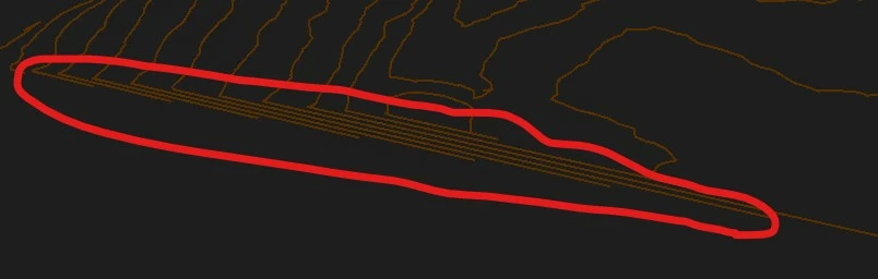

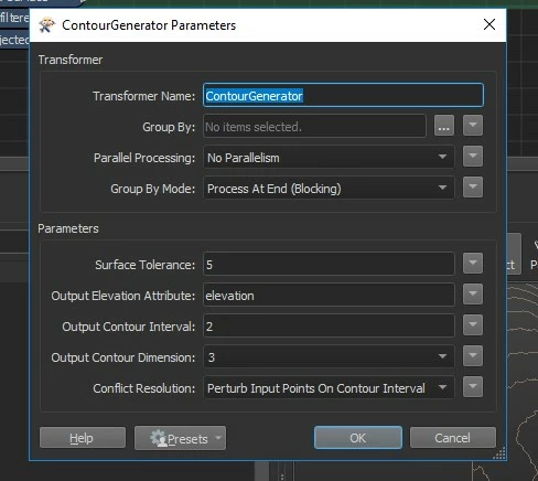

Running the contour generator on a USGS LAS dataset, I filter for ground points, then generate contours. Once this is done along the edge of the las file the contours draw to each other, like there is a straight vertical wall along the edge. Please see red circle attached. Also does not matter if I change my tolerance on the contour generator. Tried at 1 and 100. Same result

This is a result of there not being any data outside of your source point cloud. Best way to avoid this is to feed in data for a larger area than you'll actually need (if you have that data available) and then clip the contours afterwards.
Forum|alt.badge.img
  • Aug 11, 2020 8:19 PM UTC
Yes, that works, but not always available. This does not happen in Civil3d, when I run a surface model. Seems like there should be a boundary or something in fme to aid this problem.
