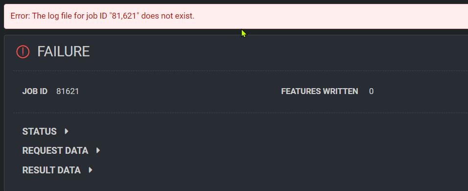

Has anyone else experienced an issue a FME automation failing to run when it is scheduled at exactly the same time as another job? We only have one FME Engine and are running FME Server 2022.2
  • August 22, 2023
  • 3 replies
  • 94 views
If I change the time to be 1 minute after the other job it runs successfully.
There is no log file as the job submitter just does not start.
FME should place the 2nd job in queue I would have thought.

Thanks for your reply
Here is the automation log - it only says that it failed to get the translation result after the schedule was triggered.

I see. I think it's best if you create a support case for this either with Safe or your local reseller.
