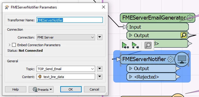

The current Automation External Action Email does not support multiple attachments and I know I can create one ZIP file, therefore I need to continue to use the existing Notifications (Classic).
My existing workflow is FMEServerEmailGenerator -> FMEServerNotifier ->
  • What do I need to do in the Workbench to pass the "text_line_data" to the Automations External Action Topic?
or
  • Is there another method of sending an email with multiple attachments (not ZIP file)

The Emailer transformer supports multiple attachments as well.

Update: as of FME Server 2022.1, it is now possible to attach multiple files when using the Email Action
