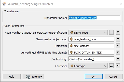

I have a problem with the definition of Published Parameters.
Using Customized Transformers when I define a Published Parameter to the type "Attribute name", creating a new attribute and having that as output, I have the Attribute name as output and not the Attribute Value. I would like the Attribute Value as output.
When I change the definition of the Published Parameter to the type "Text" and fill in the textstring "@Value(name_of_the_attribute)" I do receive the Attribute Value as output.
In the attachment you find two files.
In one you can see the results of the settings from the configuration menu. Please take into account only "Foutmelding" and "Fouttype". "Foutmelding" makes use of the above described textstring while "Fouttype" makes use of the type attribute name-setting.

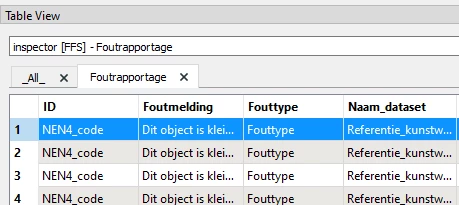

In the other you can see the output seen from the FME Data Inspector. As can be seen the attribute "Foutmelding" gets its attribute value through while the attribute "Fouttype" gets the attribute name through.
What goes wrong here? And what could I do to have the Attribute Value through? Although the textstring brings a workaround it is not very user friendly when authoring FME Workspaces.

Just set "Assignment Assignment" for a Type "Text" Published Parameter, set the Published Parameter to the attribute (name) and the values of the attribute come through.
