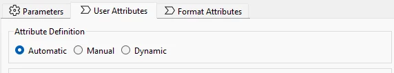

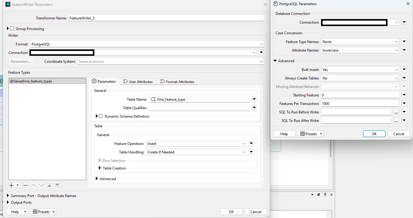

I use a FeatureWriter configured for PostgreSQL with the following settings:
  • Table name is dynamic and taken from the incoming feature type:
       Table Name = fme_feature_type
  • Attribute Definition = Automatic
  • The destination database already contains the tables (same structure).
Each feature is therefore written to the corresponding table in the destination database.

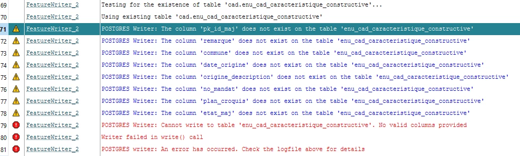

When running the exact same workspace in FME Form 2025.1.1, I now get the following error:
POSTGRES Writer: Cannot write to table 'enu_cad_caracteristique_constructive'. No valid columns provided
Writer failed in write() call
POSTGRES writer: An error has occurred. Check the logfile above for details

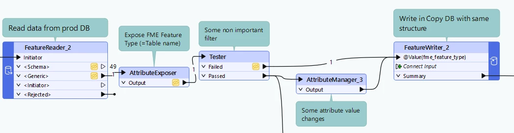

To better explain my use case, the writer receives features coming from different layers where the attribute structure is not the same.
For example:
Feature 1
fme_feature_type = enu_cad_caracteristique_constructive attributes: ID valeur
Feature 2
fme_feature_type = ma_maj
attributes:
pk_id_maj
remarque
commune
The destination database already contains the tables with the same structure:
enu_cad_caracteristique_constructive(ID, valeur)ma_maj (pk_id_maj, remarque, commune,...)
With the FeatureWriter configured as follows:
  • Table Name = fme_feature_type
The expected behaviour is that the writer takes each incoming feature, detects its attributes, and writes it to the corresponding table while respecting the existing schema in the destination database.
It seems that because AttributeManager_3 modifies (and therefore exposes) some attributes (such as pk_id_maj, remarque, commune, etc.), the writer tries to include these attributes for every feature. As a result, the writer attempts to insert them into all tables with a NULL value, even though these attributes only exist in a specific table.
This workflow worked correctly in FME 2023.2, but in FME 2025 it seems that the writer no longer detects the attributes when the table name is dynamic, resulting in the error "No valid columns provided".
