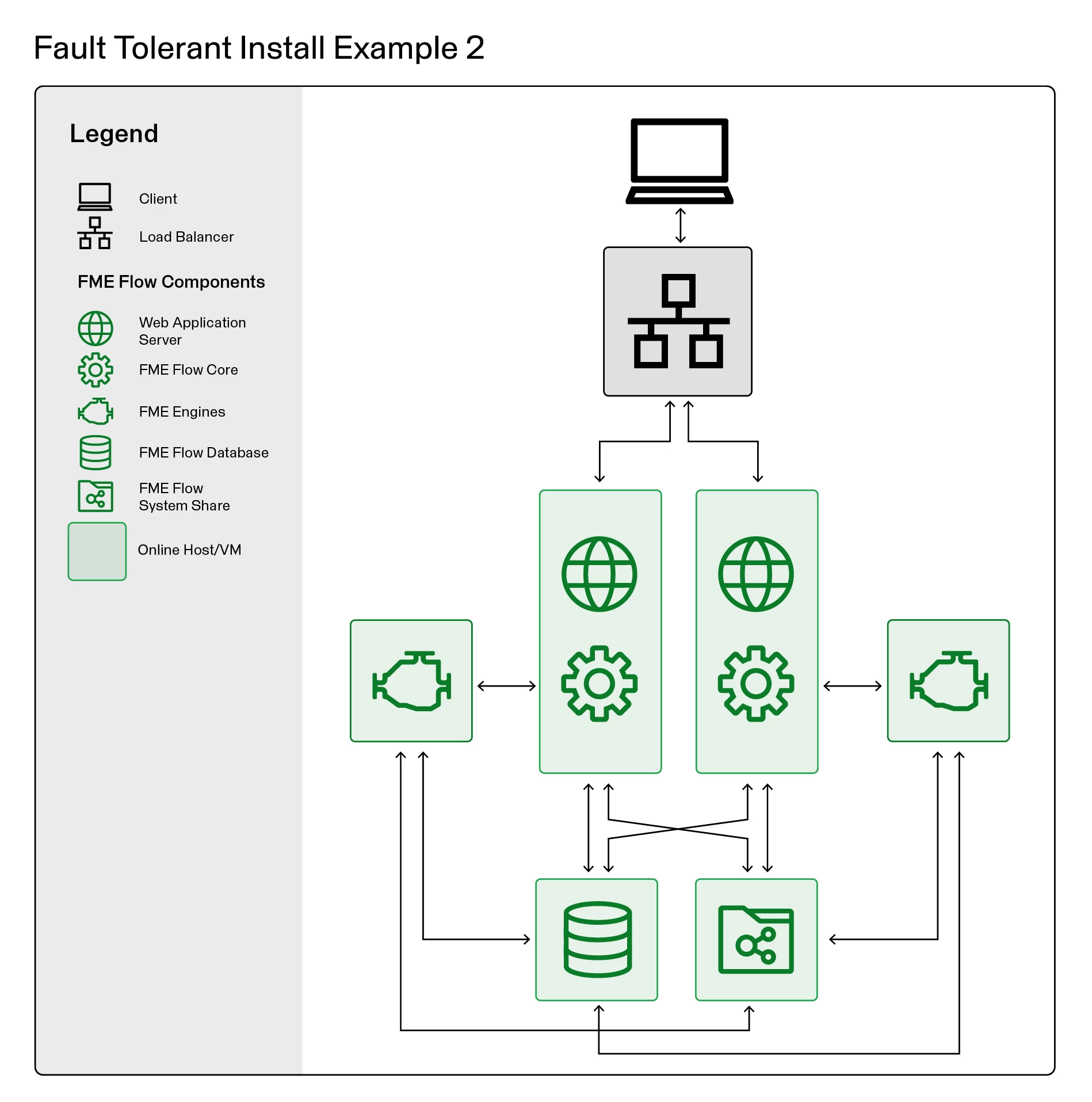

Fault tolerant FME Flow: What is it?
A fault tolerant FME Flow deployment is a high-availability installation type. It’s a lot like a distributed installation, where FME Flow’s components are spread across different machines at a single data center.*
The key is that each of FME Flow’s components is redundant - there are two (or more) web application server and core nodes, and often two or more engine hosts as well. In addition, the database and the system share can also be made highly available.
From Planning for Fault Tolerance in the FME Flow administrator’s guide.
All components’ host machines are running and communicating with each other at the same time. Another name for this is an active-active setup. It ensures that if one machine in the FME Flow installation goes down (also called a failover event), FME Flow can rely on the redundant component’s host machine to continue running.
You can select fault tolerant when running the FME Flow installer to deploy this architecture. Please note that you will have to provide your own load balancer to route traffic to the redundant web application servers.

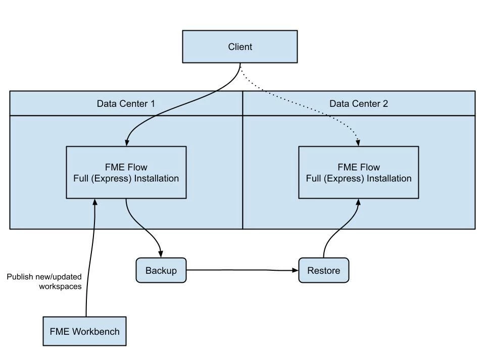

Disaster recovery and FME Flow: What is it?
Disaster recovery with FME Flow is all about recovering from a catastrophic event resulting in the loss of a data center. It requires redundant FME Flow installations across multiple data centers. If one installation is lost, another hosted in a separate data center can carry on instead.
Example from Planning for Disaster Recovery in the FME Flow administrator’s guide.
These redundant installations are completely separate from each other. They don’t communicate with each other, either. Only one installation is used at a time, so the other installation(s) do not need to be running until they are needed. Another name for this is an active-passive setup.
To make sure that all installations are in sync with each other, routine backup and restores must be performed. And, if a data center goes down, all traffic must be rerouted to the other installation.
