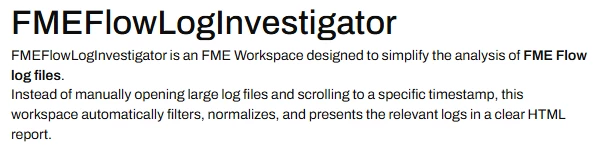

To make this easier, I built an FME workspace called FMEFlowLogInvestigator.
This workspace can be published on FME Flow with the Data Streaming Service.

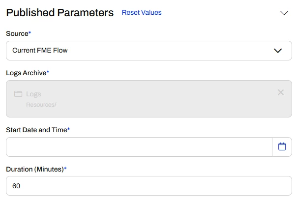

It takes four user parameters:
- Source
  Choose between:
  - Current FME Flow, analyze the logs of the system the workspace is running on
  - Archive, upload a ZIP file containing logs from another FME Flow instance
- Logs Archive
  Enabled only when Source = Archive. Allows uploading the ZIP file containing the logs you want to investigate.
- Start Date and Time
  A date/time parameter defining the beginning of the time window you want to analyze.
- Duration (minutes)
  A numeric value specifying how many minutes of logs to retrieve starting from the chosen date.

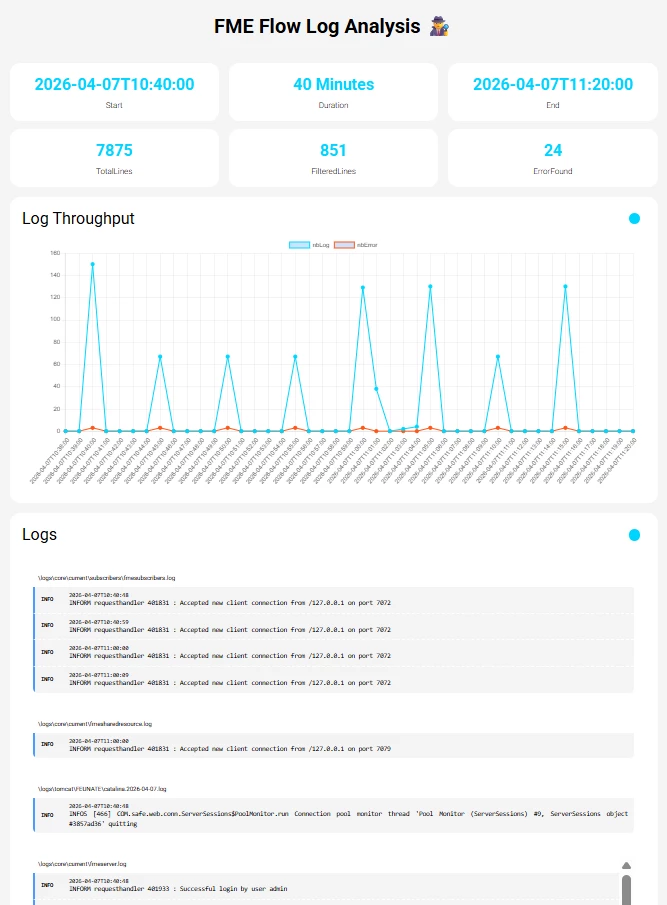

The workspace reads all log files (except job logs, since I wanted to focus on Flow services rather than Form/Engine logs), normalizes them, and filters them by timestamp.
The output is an HTML report (built with BRG transformers!) that lists all log files containing entries in the given time window, and displays those logs in a clear format.
It also includes a chart showing log throughput (events per minute), which helps to quickly identify moments of higher activity or error spikes.
From my testing, it works quite well: it lets me focus only on the relevant files and time window. I also think it could help new FME Flow admins get familiar with the different logs, without having to manually open them all.
