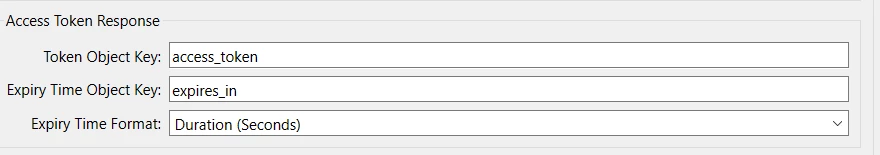

I have an HTTP caller using a GET Request, to access an API site using a Web Connection for authentication. I am trying to find a way for it to return (either within the JSON response body or otherwise) the access token which is generated when the process runs
I have Accept and Content Type as my headers.
I have tried:
  • Storing the cookies
  • doing grant_type = client_credentials in the Query String Parameters.
  • Creating a list for the Headers (no token content within that)
In the setting for my web connection, I have this:
But I am not returning anything called ‘access_token’ in the response body. To be clear, my process works as intended, but due to new constraints we need to store the access token that is generated every time to store it to use downstream

I’m not sure if I’ve 100% understood your problem but I’ll do a dump of information which may or may not be helpful 😅.
The stuff which happens in with web connection is not included in the _response_body, this is abstracted away in a kind of pre request.
Every time a web connection (like yours) get uses FME should first check to see if the token it has is expired based on the Expiry Time. If it decides it’s expired then it will generate a new token using the Access Token Request parameters. FME should automatically be storing and reusing the token.
The required API request will then be made with the token put where it needs to be defined by the web connection (in the API Call Parameters).

In the above case I’ve used an FME Server web connection and called localhost/fmeapi4/jobs.
In the first 3 lines you can see that FME has checked the expected expiry time of the token and has decided that the local one it has should still be valid (“Expiry time” is bigger than “Current time”).
Next it makes the request defined in the HTTPCaller. All the lines with the [1] relate to the first call. in the request headers we can see one called “Authorization *******” - This is where the token is used.
In the response headers if we look at the Status we see a 401 error which is typical of a permissions issue - This is because I disabled/invalidated the token on FME Flow.
Before the next request we see some more lines relating to the web connection. This time the expiry time is smaller than the current time (presumably because it was returned a 401 error it updated the expiry time). There is then a line “Updating access token in connection storage...” - This is where we see FME using the web connection to generate a new token based on what’s defined in the connection.
We then see a follow up request [2]. This also has an Authorization header set but this will be with a new token. The response it a 422, which means I messed up my request but it was authenticated.
itsmatt
Forum|alt.badge.img+48
  • Mar 24, 2026 7:51 PM UTC
FME should be keeping the latest token in the web connection storage locally, so if you’re reusing the same web connection it should be reusing it unless it’s expired. You can turn on Debug logging to see if FME is always updating the token via the web connection. You wont be able to see the actual token though, it’s usually represented with **** in the Authorization header.
If you need to get the token then you’ll need to replicate the behavior of the web connection with HTTPCallers (without using a web connecion).
