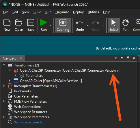

Let me know how that goes, and/or what version of the OpenAIChatGPT connector you’re on! You should be able to see that in the Navigator

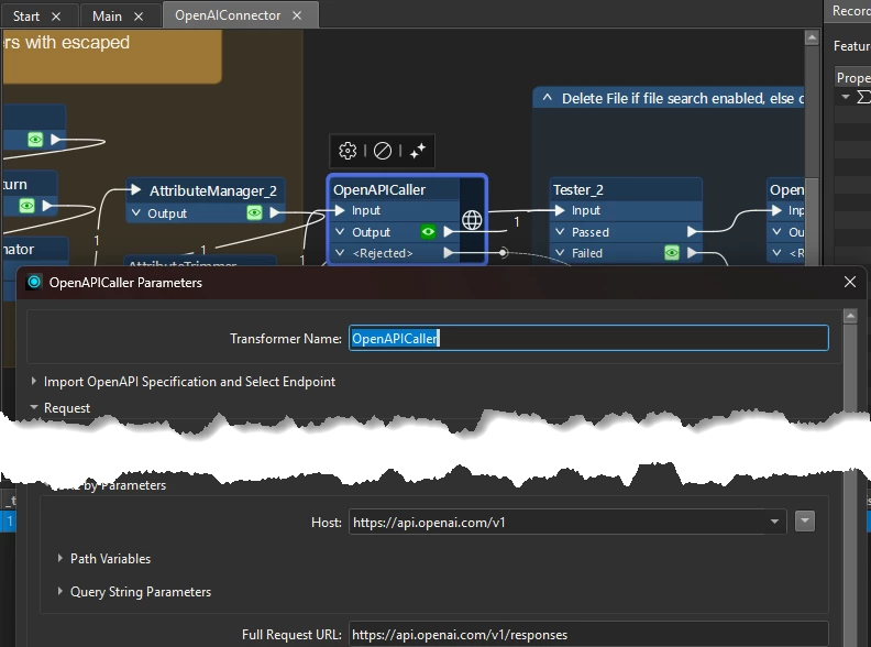

Thanks - yes version 7 for chatgpt connector. The open API caller seems to request a json file, what the syntax of that json file required? what needs to be included? thanks

Would you be willing to share a screenshot of where it's requesting the JSON file? That will help narrow down exactly what endpoint is expecting a JSON file. I don’t seem to get a similar error when testing the ChatGPTConnector so it’s difficult to say for sure.
That said, it may be referring to the request body for the Chat Completions API, the basic structure looks like this:
