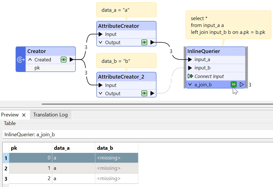

  • Apr 2, 2026 2:53 PM UTC
I just tested this with FME 2026.2, the behavior looks as I would expect. If a table referenced in a join is empty (no input features), the InlineQuerier is still able to to execute the join, leaving the joined attributes as missing:
An inner join will not return anything, as expected.
There are no errors or warnings in the translation log.
Interesting note: If I disconnect the connection to “input_b”, the attribute “data_b” is not <missing>, but not present at all.
