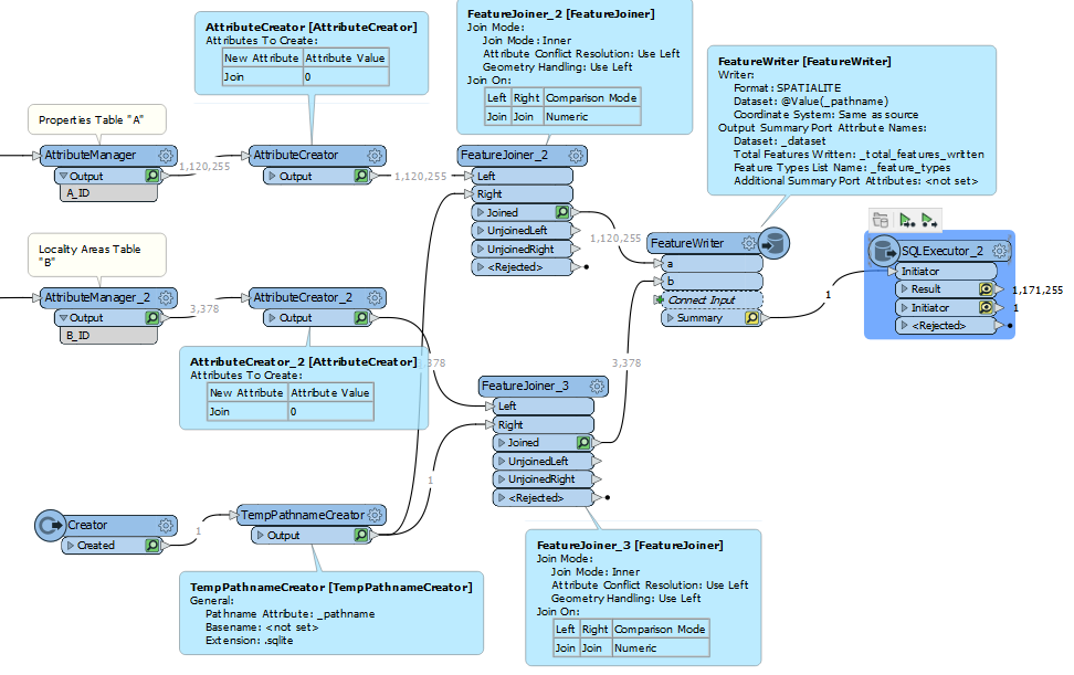

However, I’m going to put a left-field solution up though which is a Spatial SQL based solution that can be high-performing and maybe easier sometimes to translate existing SQL into FME.
What we can do is create a temporary Spatialite Database in-workspace, and run SQL against this.  The first bit is a bit clunky, in needing to generate a temporary FME file name and joining that to the records to use FeatureWriter to create a temporary Spatialite Database, but after that we can run SQL against this to mimic the original PostGIS syntax.
The ST_DWithin() part of the clause is a bit funny, in that the second part of the clause that uses ST_Intersection() will only evaluate to True if Distance is = 0………..not 100 metres.  So instead below I’ve just used ST_Intersects() as the test rather than ST_DWithin().
Within the SQLExecutor then is a replica of the original PostGIS SQL, although as above, used ST_Intersects() rather than ST_DWithin().  I think the original author was worried about coordinate rounding errors for triggering the spatial index so was using ST_DWithin() as a kind of buffer to make sure the spatial index in PostGIS picked up all possible intersecting candidates, but in Spatialite, its spatial index already has a degree of buffering in it to handle these edge cases so we don’t need to use that strategy.
