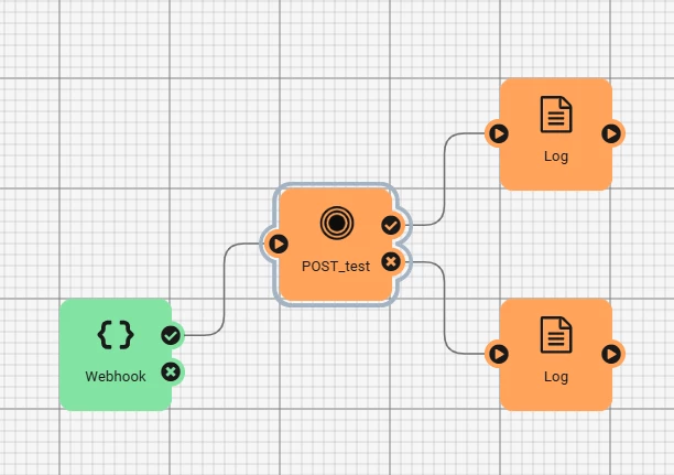

I want to take the text body sent to my automation via a webhook and use it as the input to my workspace.

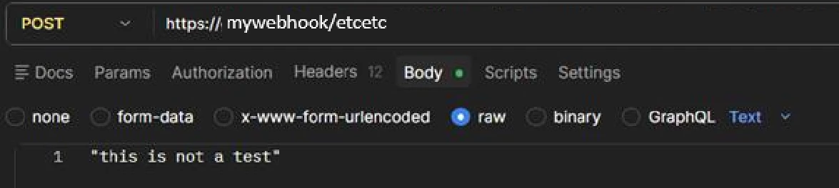

So this would be the POST
I’d then like to pass “this is not a test” into the workspace POST_test (below) so that I can process it further in the workspace.

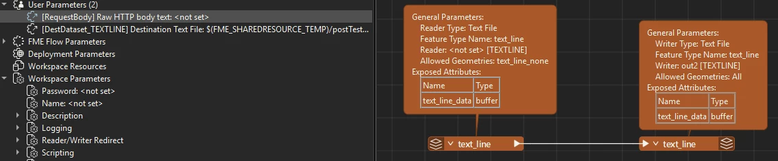

I imagine the issue is that I’m not defining where the information is coming from when entering the workspace, which is just a text file reader and text file writer for the purposes of this test.

Further searching suggested setting the source as a user parameter.
I’ve tried to set the input as text string using a user parameter but this doesn’t remain in the reader after clicking ‘ok’.

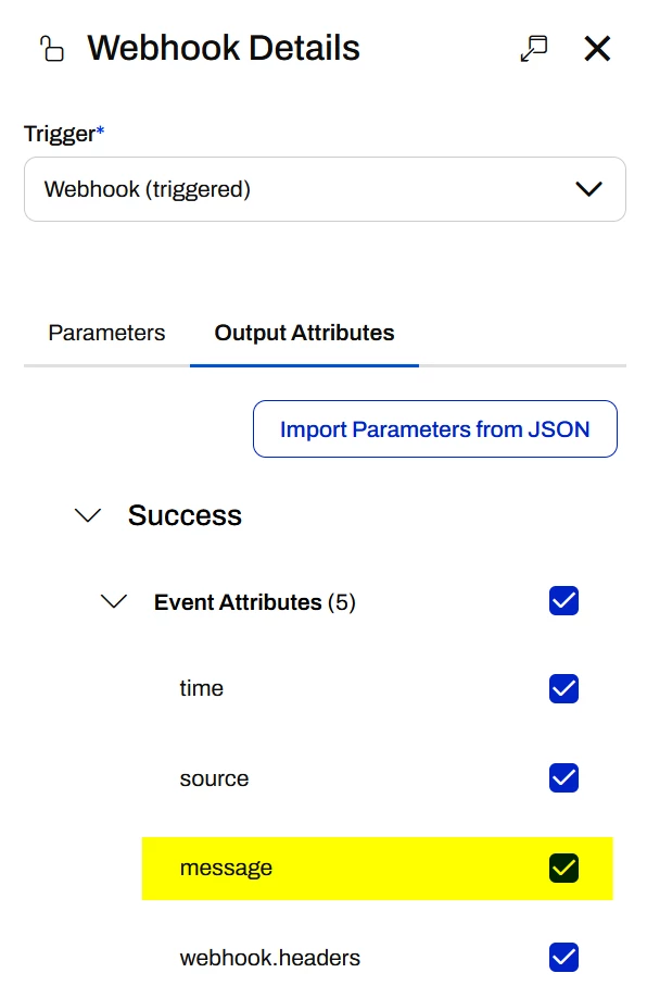

You have to link the webhook message to a published parameter of your workspace. First make sure the event attribute “message” is activated on the webhook trigger:

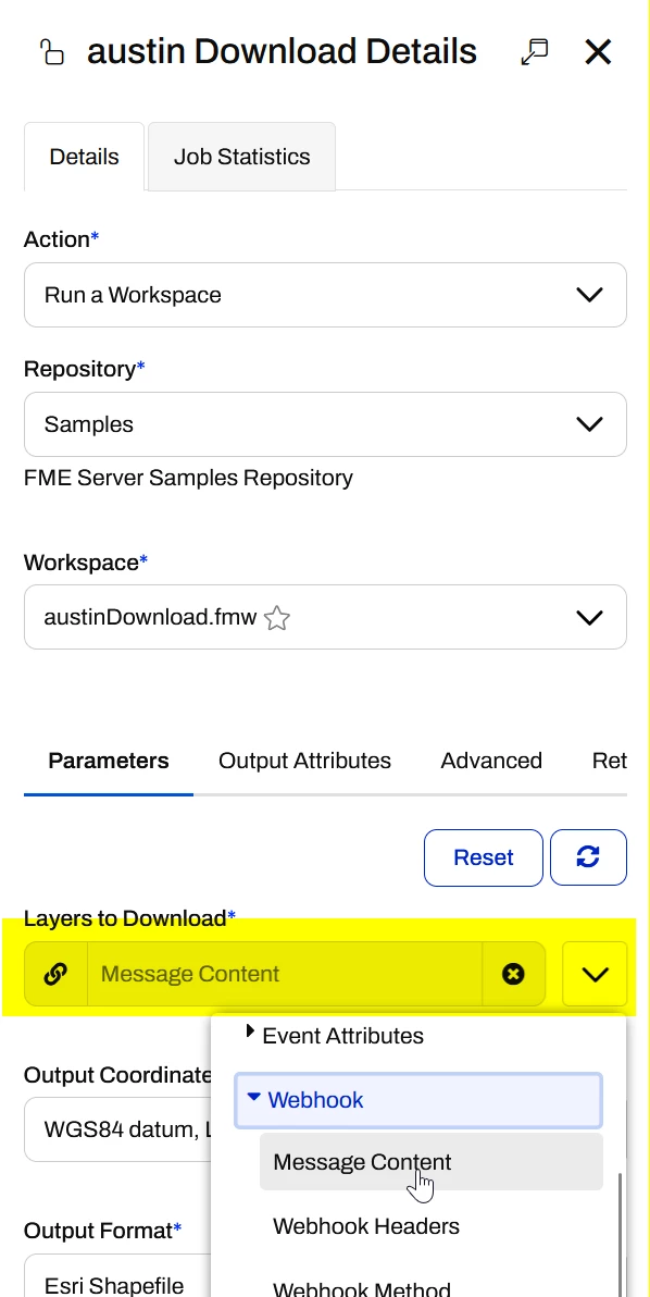

Then on the workspace, attribute the webhook message content to a published parameter, e.g.
This published parameter should be a simple text parameter, which you can access e.g. with a ParameterFetcher. Note that the message content is not a file, so you cannot link it to e.g. a text file reader.
