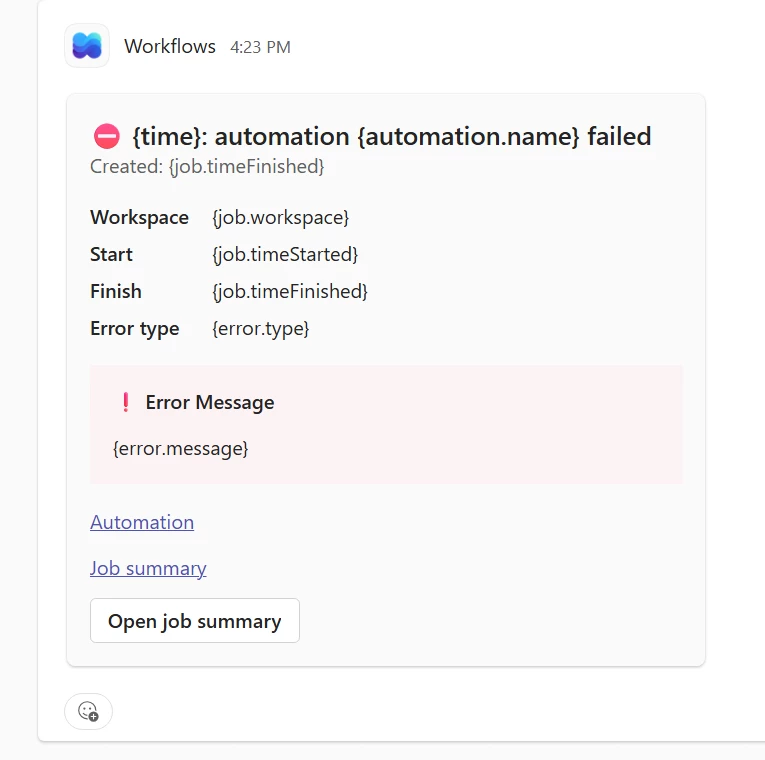

It seems the issue described in the related topic, where the job variables show in the result, instead of the values, has never been resolved. Or the issue has returned in version 2025.2.4.
As a workaround I can send an email to a Teams-channel. But I looks a lot better when I send an adaptive card to the channel, using a Workflow in that channel.
But as described in the related topic, when I send a adaptive card with a HTTP Request in an Automation, a job variable like {automation.name} just shows as {automation.name} in the result. Of course I would like it to show the name of the automation.
Is there a way to make this work? Or is this a bug and I just have to wait when it will be fixed?

This creates a good looking message in the Teams channel, but {job.id} stays {job.id} and will not turn into a number.

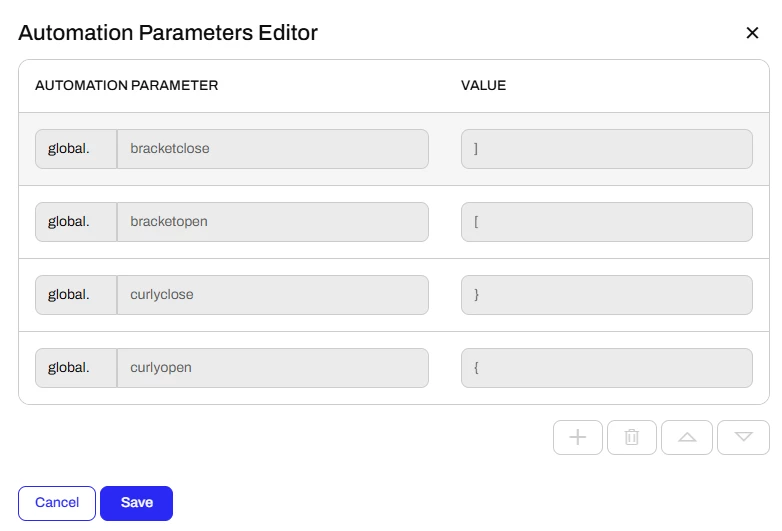

I had the same issue. I described my workaround in the previous post. But now I have applied a better workaround:
  1. Create four Automation-parameters:
  2. Replace all (curly)brackets in the json with the automation parameters, except the curly brackets of the other parameters (automation.name, job.timeFinished, etc.). Now I have this “json” as the body:
    {global.curlyopen}

Does that answer your question?
