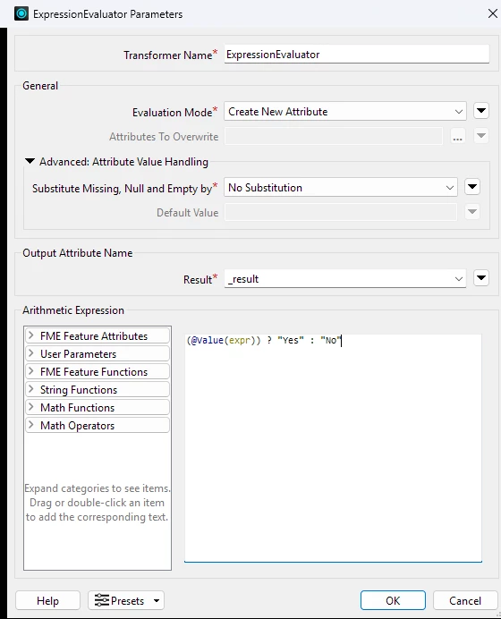

I’ve tried to utilize ExpressionEvaluator with the expression @Value(@Value(expr)), but it doesn’t return any value in the “_result” variable.
What am I doing wrong, and is it even feasable ?
Are there better ways to achieve this ?

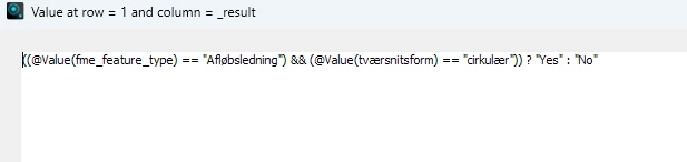

Here’s a sample value of the expression:
How to I force FME to evaluate my expression ?

I don’t think you can use the ExpressionEvaluator to compare strings which is where the issue is.
It works if you supply an expression in an attribute that is doing a numeric test
Is there a particular reason to use the ExpressionEvaluator?
Could you build an expression like this instead?
I’m not sure what exactly you’re looking to achieve but there are probably better ways
