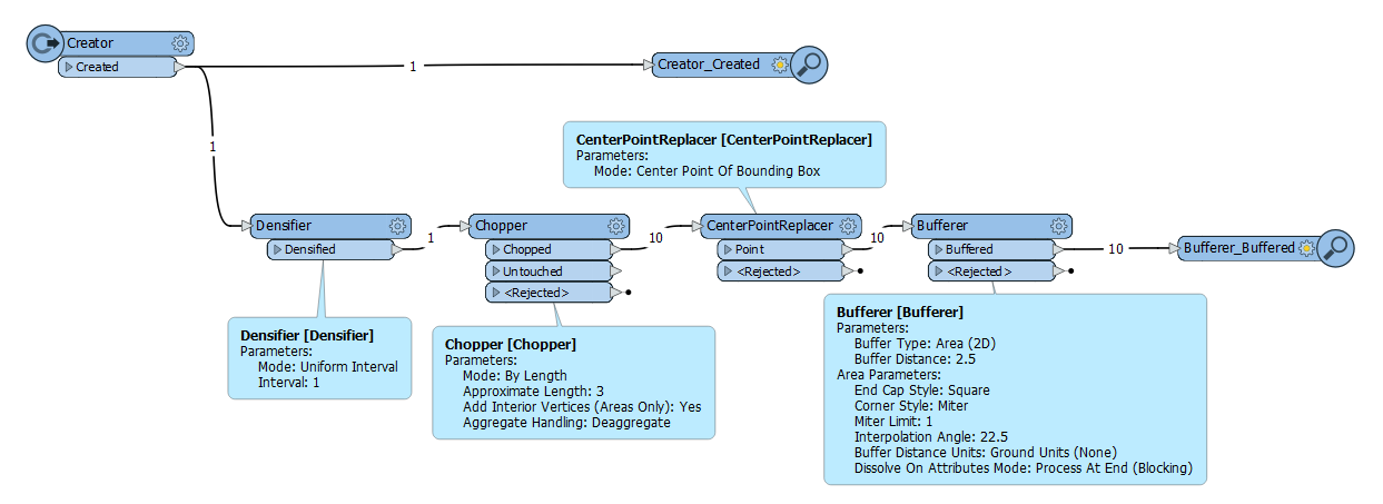

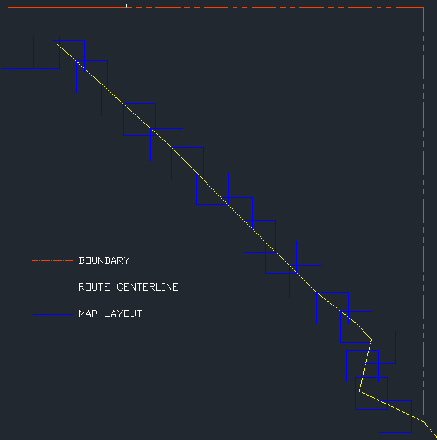

I am trying to figure out how to create map tiles along a route where the tiles have a certain amount of overlap, something similar to strip map index but not with rotating map view.
Best answer by erik_jan
I created a sample workspace to do this:
The workspace can be found here: Maps_on_line.fmw
Hope this helps.
Hope this helps.

thanks erik this works well,
