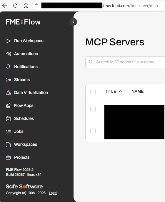

I was hoping to set up an MCP Server on Flow hosted, but I can't seem to find where it is in the interface. The current Flow Hosted 2026.2 beta build is 26267, do I need a higher build in order to use this?
I did see it mentioned in the user permissions, but other than that I'm not seeing it anywhere else in the interface.

I’m using a Flow Hosted 2026.2 beta (build 26267), same as you.
You can just add /mcp in the url, and the mcp servers tab opens. The UI isn’t there in this build.

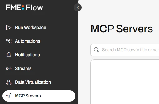

Not Flow Hosted but on premise I installed with
FME Flow 2026.2
Build 26298 - win64

That’s it, thanks!

The latest Flow 2026.2 Beta build (26298) is also now available to launch on Flow Hosted.
